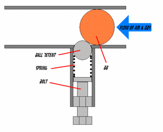

Following these ideas, here's a theory on how to make a device that would allow you to adjust the rate of fire of an ordinary cloud/vortex BBMG. The idea is pretty much self explanatory, the spring loaded ball detent resists the motion of the BB until it's pushed down, allowing the BB to escape and catching the next one, allowing the cycle to continue. Altering the spring compression would change the force on the BB and thus change the rate of fire (more compression -> slower ROF).
The added benefit would be that the flow restriction while the BB is "caught" would allow pressure to build up in the chamber, meaning the BB would be released at higher velocity which would compensate for the slower fire rate.
There is one problem I forsee, blocking off the flow might cause feeding problems in the case of unassisted cloud or vortex BBMGs.

I saw a something similar once, except it used a magnet with steel BBs
Ah, but this is adjustable

i don't think a magnet would be reliable enough also like jack said it's not really adjustable.I saw a something similar once, except it used a magnet with steel BBs
and jack i think it's a great design only i think you should put two, one each sid of the barrel to give you more adjustability
I found that with my vortex strafer when using a hop up (it wasn't ajustable but could have been) it made more of a plop plop plop sound instead of the usual whirring.
If the ball detent was replaced by(or coated with, or...) something with a little more friction you get the hop up effect too

If you stick with one detent I’d suggest you put it at the top of the barrel that way the backspin doesn’t throw it into the ground.

Instead of the piston you could also use an o-ring. Or perhaps something like this.
The generally idea for the firing cycle is;
1. The trigger is pulled, air starts to flow at high velocity into the chamber (and out the barrel) and the cloud/vortex chamber works normally.
2. Eventually a BB loads into the beginning of the barrel but is stopped by the tubing (or an O-ring), sealing the barrel.
3. Pressure builds in the chamber, the cloud/vortex stops working since there is little/no air flow out the barrel.
4. Eventually the pressure in the chamber builds enough to force the BB through the tubing.
5. Since the tubing alone doesn't close off the barrel, air pressure blows the BB out the barrel.
6. The barrel is now unsealed and dumps air, rapidly lowering the pressure in the chamber.
7. As the pressure in the chamber drops, air flow into the chamber increases and the cloud/vortex starts to work again.
8. Eventually a BB loads into the beginning of the barrel but is stopped by the tubing, sealing the barrel... and the cycle repeats.
With a cloud or a vortex design, air pressure will hold the next BB at the breach until the pressure is high enough to launch it. There wouldn't be another BB imediately behind the "chambered" bb since there is no force to hold one there.
When a bb is launched the lag time before the next bb gets blown into the "chambered" position gives the air flow needed to get the first bb out the barrel.
As with Jask's concept, the time the bb is held while "chambered" allows the pressure in the bb resevoir to rise.

Indeed Jimmy, this is an extension of the O-ring design, the difference is that while the seal is not as good, the fact that it's adjustable makes it a bit less of a suck-it-and-see approach.
Ah-hah, here's just a thought for one and all. Places like aero-modelling shops sell silicon rubber tubing in a variety of small diameters including one with a 6mm ID.
Now imagine you take a short bit of this, push the barrel end in part way and push the whole thing onto the chamber outlet, LEAVVING a small gap between the two rigid tubes. Now you could do something as simple as wind a piece of wire round this and twist it to constrict the tube. And voila very simple adjustable system, completely air tight and providing a good BB to tubing seal.
Oh and it's cheap stuff but you usually have o by it by the metre/yard, so when one bit wears out you just fit another bit.
