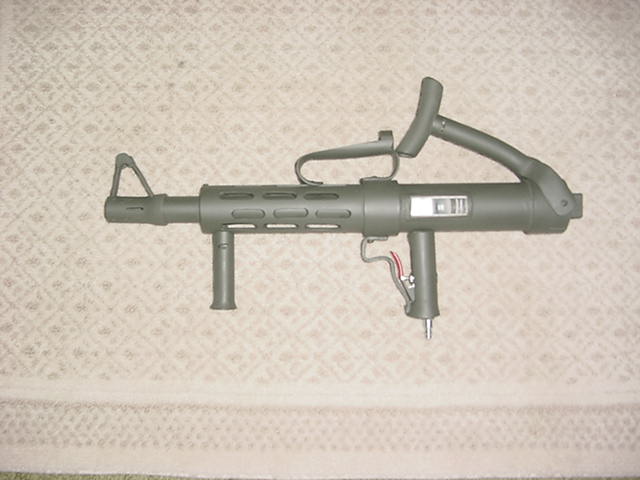

This is the last one I am going to make for now.

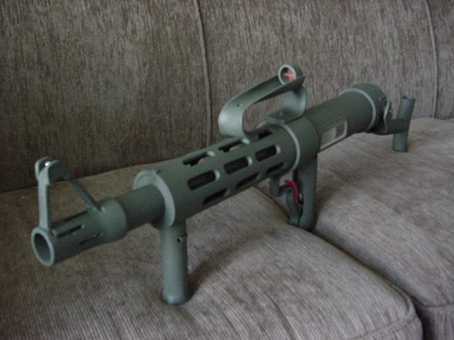

The barrel is a 12 in. airsoft barrel, and the vortex block is made from plexiglass. The stock and sights are made from 3/4 pvc that were cut heated and bent into shape.
I use big screw head bolts that were epoxyed to the back.
The back sight is 3/4 pvc with trimmer line for the crosshairs.
The ammo window is plexiglass epoxyed on.
The barrel shroud was slotted out with a dremel saw blade.
front view
front view
back view
back view

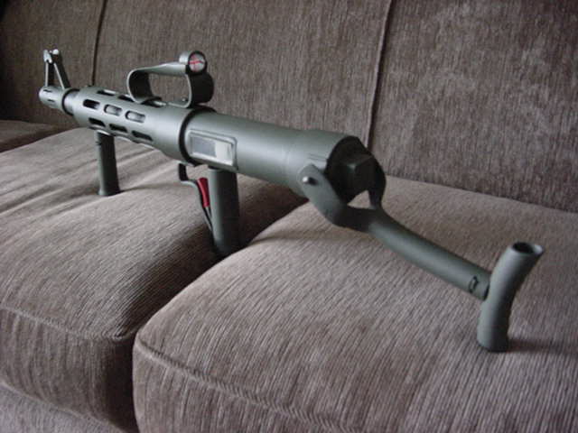

stock up
stock up

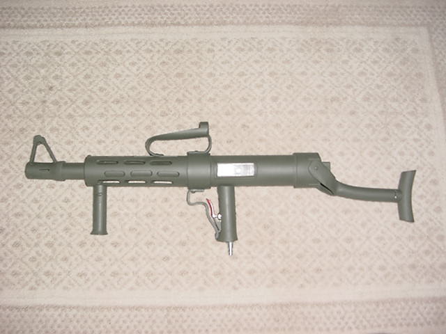

stock out
stock out

Awesome job, looks like a lot of fun,
I've never seen anyone shape pvc like that.
I really like the window and the styling.

that is absolutely beautiful mate!
loving the fold out stock and all the effort into the pvc shaping :D

That is a beautiful gun! Looks like you payed a lot of attention to details. Great work :)

good job, but I would remove and paint the rubber sleeve on the airgun.
The body looks good and I'm lovin the stock but my favorite thing about it is the fact that you used an actual airsoft barrel and not brakeline like a lot of noobs.
Overall I would give this a 8/10. Good job.

sexualness.... that is beautiful. /did you bend the front sight to shape aswell as the muzzle break?

Thank for your comments, yes, I heated the pvc and bent it into shape, cut some notches in the mussel break and glue it in. I am going to cut off the red plastic on the trigger blow gun as Davidvaini said and paint it so it won't show as much. I have an idea to put a sliding trigger, like on a 45 Colt, to slide back and push the air gun lever.
