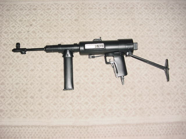

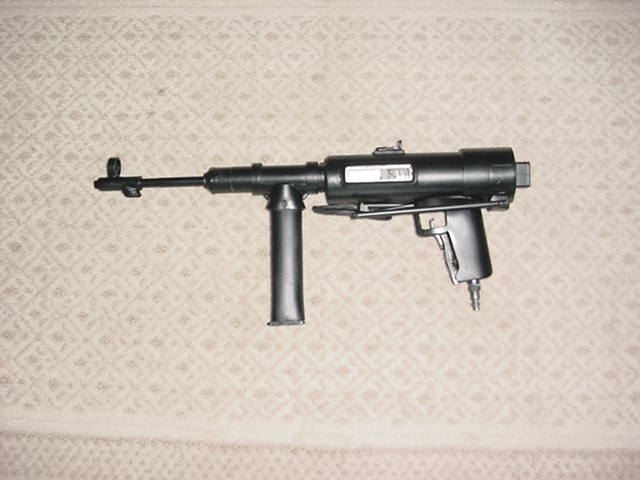

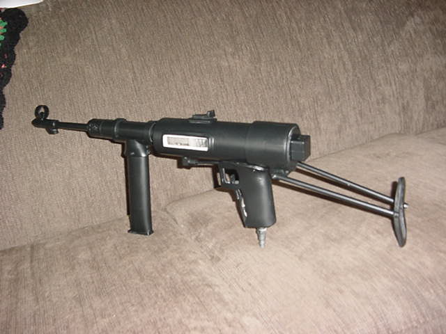

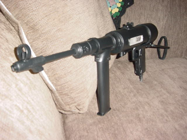

XxtriviumxX said my last bbmg looked like a MP 40. After seeing the picture I decided to make one.
I tried to make it as close to a real one. It has a tight bore barrel 12 in. long. the grip and mag and about everything else is pvc. The tapered outer barrel is an old golf club shaft. I used ferrel fitting to run from the blow gun to the block which is plexiglass. I put a smaller plexiglass window in this one.

It doesn't cost much to build one. The barrel cost more then anything else. It takes a lot of time because everything is custom fitted.How do you post a video? I've looked for information but haven't found anything about posting videos. I can take the grip off easily and may put a push button blow gun in place of the one with the handle. Fix a trigger on it to push against the button.

I'll have to try a video. It is accurate, doesn't spread the bbs like some I 've made. It would keep shooting through the same hole if you didn't move it. I've only tried it at 25 feet for test fire.

I heated a 1 in. piece of pvc and flattened it and flattened the T where it went in. I cut a piece of pvc for the bottom of the clip. The grip was 2 in. heated and formed.
I have a radiant heater in the garage that i use to heat up the pvc. I can hold it their till it get soft without burning it and then form it the way I want.
