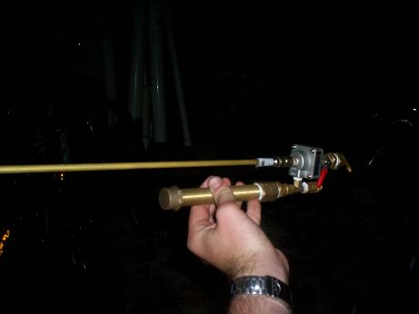

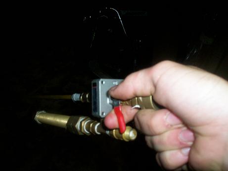

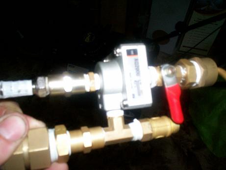

heres pics of my above mentioned bb gun:
here it is, 1/4" SMC Pnuematics QEV as a valve

wow that looks umm decent !! very nice
