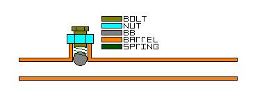

Well, if you are afraid of the rubber wearing out, this should work for you.
Hop-Up
Hop-Up
hop up.JPG (8.02 KiB) Viewed 5211 times

ok. thats really neat. i like ur idea. i just wanna ask what is the bb made of because it's gotta have some friction to put some backspin on the projectile. metal or plastic won't do much but decrease the fps. the design is awesome though.

i-will wrote:ok. thats really neat. i like ur idea. i just wanna ask what is the bb made of because it's gotta have some friction to put some backspin on the projectile. metal or plastic won't do much but decrease the fps. the design is awesome though.
I was thinking that it will produce friction whether it be plastic or metal since the friction is being cause by the downward force of the spring. If there wasn't a spring it wouldn't work.

Mon Sep 29, 2008 5:40 pm
i'll try that out. i've seen your mp5 (littlebro05). it's freaken awesome. that what i like to see. it's functional and ready for the field. and i love mp5 (sd6). i hope u ready my responses to both of the topics. i'm not a fan of negative energy. oh yeah. the point of the hop-up that i made was to keep it as simple as possible. as long as the hole has smoothed edges the rubber won't wear very fast. it's easy to replace the rubber. i don't mind the extra work though so i'm gonna try ur method.
