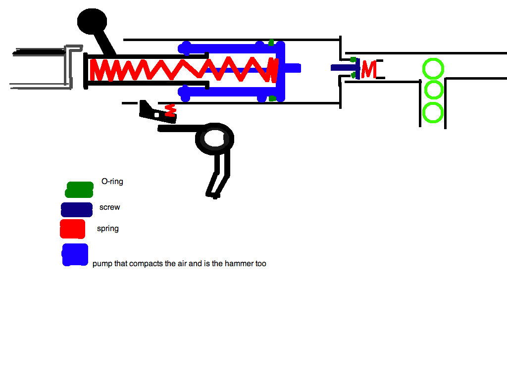

it's a diagram of a spring bolt airsoft gun. it's really simple, powerful and you don't have to buy Co2 or pump it's quick to!!!
the bolt slides in the hammer/pump and you pull back, pump follows the bolt until it locks on trigger and you push hammer forward (the pump/hammer stays on trigger) then you lock the bolt in the bolt lock.
AND FIRE!
Ps tell me if you don't get it.
also its nice to have a stock more cumfy ;)
i've done a simple design if you don't get your probably really really realy weird  (retarded). :I

I know the danger of springs is going to be mentioned during this thread, but i say go for it. Behind the bb's, that air stopper would be hard to make in my opinion, and probably isn't that nessesary, but it could boost performance a bit.
Edit: Now that i am thinking about it, i really dont think that stopper would help at all because it would just limit flow and would probably cause bad performance. Correct me if i am wrong though.
Another Edit: Alright, now i think that it would only work if you were using extremely stiff springs. That piston would have to move very far and compress a lot of air to reach that hammer valve, and that small valve would need a stiff spring also to keep that pressure in until hit by the bolt. Final decision... :P But the drawing is probably not drawn to scale... im stopping now.

airheadnoob
Posts: 61
Joined: Wed Jan 30, 2008 11:12 am
Tue Oct 14, 2008 11:47 pm
its basically a spring bolt gun you know the ones u see on youtube
in about a month or my next school holidays ill try to make it its gonna be hard cos i live in australia

What exactly do you want from this design? If it's a repeater to be used for skirmishing, I suppose a low powered magazine fed springer would be an ideal choice. For anything else however, a simple pneumatic would offer much higher power potential and be much easier to construct. A combustion launcher would be even easier to make. I would take this into consideration before proceeding with a springer.

the backwards hammer valve won't be able to hold the pressure and open on impact without a super stiff spring in both the valve and the bolt. u'll need a commercial spring press to even get it in place. then u'll need something like a pully system or massive arm muscles to cock it. this wouldn't be very handy against an army of AEGs and GGBs. u would barely leave ur garage (where ever u build stuff) with it.
it's a great theory to test at home or school but it'll get u nowhere in a game.
it would be great if u can prove us all wrong. go for it.

oh i only did that screw cause i can't find out how (the ones buy) it works cause i now there is a hammer so there must be something like that.
and i posted this so others can either try or find out how it works :)
