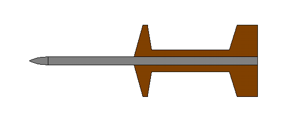

As to making a practical dart projectile, consider this:
It won't be reusable in that the fins won't survive the impact, but you can easily make a jig that will enable you to mass produce ammunition. The main advantage is that the sabot can be a simple cylinder without having to separate etc.

The problem with that design is that the tip is not supported and tends to be off center in the barrel.
Mon Dec 29, 2008 3:24 am
irisher wrote:The problem with that design is that the tip is not supported and tends to be off center in the barrel.
.. hence the unfeasibly wide fins. Another alternative that's a bit more labout intensive would be to have a second set of fins, or simply shape the fins as shown below:

Equally, if the base of the fins was square with the axis of the core, then the simple acceleration of firing would line the nose up squarely in the centre.
Under the forces of a proper cannon, gravity's effect on the tip is pretty negligible.
Consider, cannons use forces that can accelerate projectiles to hundreds of m/s in barrels of a metre or two - in the same kind of distance, gravity will manage a lone few m/s. As such, the impulse of gravity is pretty easily ignored in internal ballistics.
For a couple of numbers, HEAL will puts an average ~335 newtons of force on a 20g spud slug - gravity, about a fifth of a newton. The force of the pressure in this particular case is about 1700 times greater than that of gravity. So, as you can see, considering gravity in internal ballistics is generally pretty moot.
Also, to get back to the original point, bear in mind the inverse is true - unsquare fins would send the round wildly cascading.
can you tell me someone who has made one of those because they look difficult to make
