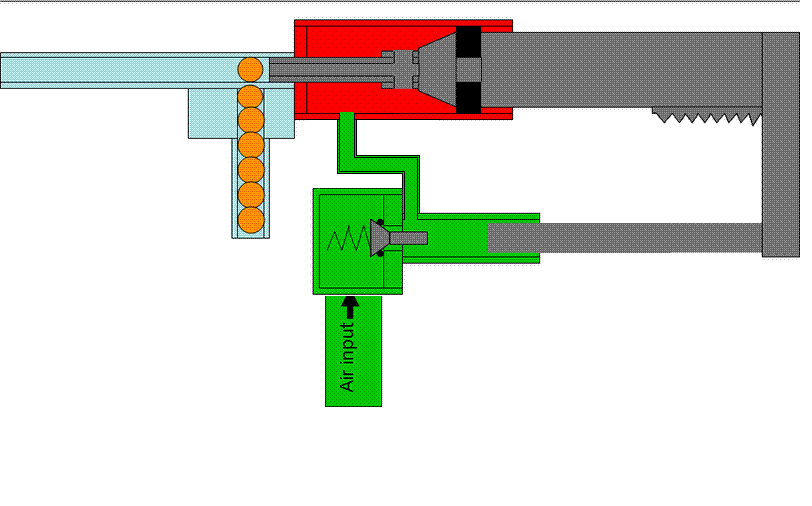

the following design is adapted from 2 of Antonio's designs
the first one I can't find at the moment I believe it was his design with the hammer valve perpendicular to bolt,
however I also added a second valve and piston thing to help cycle the bolt,
http://www.spudfiles.com/forums/automat ... 13665.html
my experience wit hammer valve and automatic airsoft gun designs back when I was more involved with this forum tell me that the blowback force will probably be too insignificant to cycle the bolt alone, using a separate valve provides much more force because it's like mounting a separated airgun used to cycle, but when they feed off of the same valve the air dumps out the barrel so fast that there is hardly any pressure to cycle the bolt

and this is the mod I proposing
also tell me any of your suggestions for moding an airsoft AEGs to run on air

Brilliant concept but I don't think that valve arrangement will work, I would go with a single hammer valve feeding directly into the chamber. i modded your diagram just to show the idea, in practice you'd eliminate a lot more dead space.

I could get the springs to go in place if that's why you don't recomend it, I was ignoring that detail,
you and I both know the difficulty of getting these things to cycle, I never got the thing to cycle even once; ant was able to make his full auto work because it had 2 valves, in practice using 2 valves actually reduces dead space its just wastes more air. In the diagram your suggesting all the air directed on the piston might make it cycle prematurely or if the pathway between the side piston and bolt is larger the air is likely to be dumped out of the barrel quickly and not cycle. When you have 2 valves you can practically think of the 2 valves as being not connected, with all the air from the second valve dedicated to cycling the gun you get more force to ensure the bolt cycles, more force will make it more reliable like long stroke gas pistons on AKs

I would mae the recoil chamber just as wide as tube the bolt travels in. What I think is have two hammer valves just like antonios stacked tube.
With the recoil cyclinder just above the cylinder that the bolt travles in making for less ''Bending'' forces on the rod that connects the recoil bolt and the fireing bolt. Jack I think your diagram has alot of dead space and wouldn't be too powerful. Actually if you use jacks design you could make it have very little dead space because you wouldn't need the cone part on the fireing bolt.

I would make it in such a way that the "hammer" portion is simply a rod that would be of minimum area giving the air little place to push on, and connect the tubing from the valve to the breech in such a way that it doesn't contact the main piston, and leave the cycling completely to the motor.

Sticky_Tape wrote:I would mae the recoil chamber just as wide as tube the bolt travels in. What I think is have two hammer valves just like antonios stacked tube.
yes that's exactly what I'm proposing in the diagram

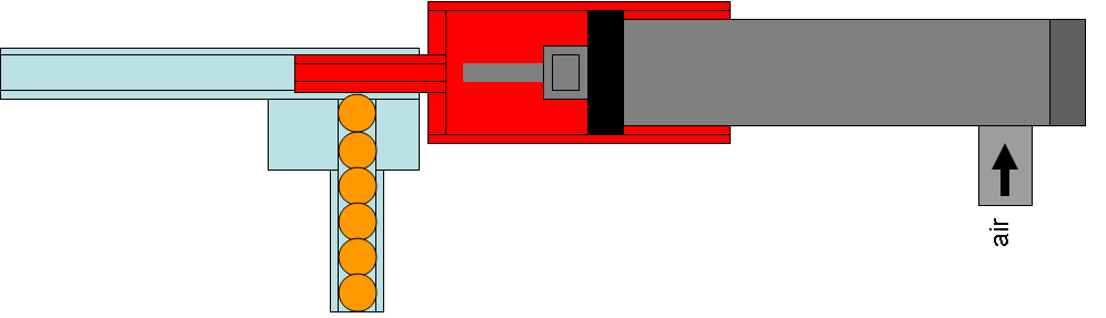

I just drew this, it's just for a blow forward bolt mod, I'd have to rig it with some valve system if I wanted it to shoot it in full auto or not to drain air when trigger is pulled
