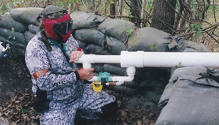

mike1010 wrote:i have a regular scuba reg(the kind you use while diving), and i think that the first stage has 145 psi output but i only can find 1 source to confirm this. i have several air compressors big and small, but my problem is something i can bring out on a feild, with no power.
you are correct, this is my setup that i use in paintball games. you can see the scuba tank and reg behind me.
