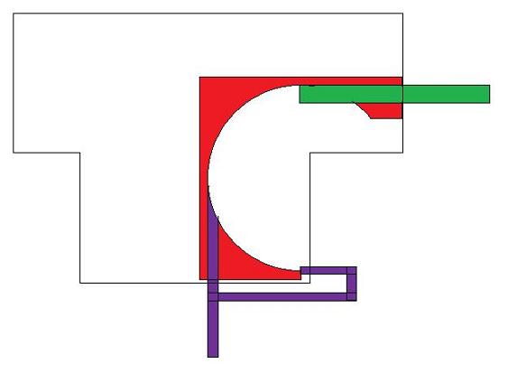

Below is an untested block I designed.
Edit: My design would work in a tee joint well.
Custom Vortex Block.jpg (13.73 KiB) Viewed 2459 times

SpudsMcGee wrote:Full circle= Easier to make. Just drill three holes.
Half Circle= Harder to make, but it might make it easier to fire all of the rounds.
Half (-around 3/4) Circle= Less work, or the same amount if you want to boost performance even more with a little filing. Other than that, you drill two holes in your block of material and you're done.
You end up with better consistency, no jamming, you'll never need shrouds, and it'll fire to the last round.
