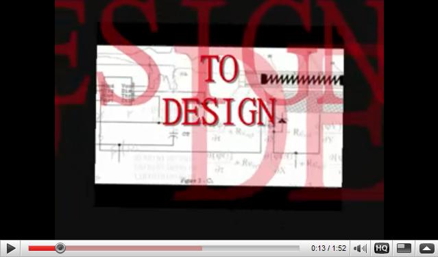

Actually, it might function like the Drozd with a solenoid operated hammer, I took this screenshot from the beginning of the video that uses what looks like plans and there seems to be an electronic circuit involved. He also mentions the Drozd a lot in the write-up.

True, but no harm in asking ;) though I think that the mention of an infinitely variable rate of fire is also consistent with a solenoid hammer valve, that's looking like the most probably mechanism to me.

or it might be just a 3 way solenoid spool valve... one port is the chamber, one for the barrel and one for the tank... a 1/4" valve would be enough to provide good flow.. with a small chamber volume it wouldn't' be difficult to get multiple shots
the loading mech/bolt is most likely based on the drozd

It could be, but I think a solenoid hammer would be much easier to improvise.
