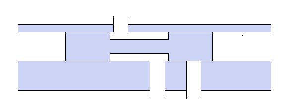

store bought, they are expensive. if you wanted to machine a spool valve and actuate it with a solenoid, it would be much cheaper, smaller, and could be built to withstand immense pressure. attached is a diagram of a 3 way spool valve. The "spool" slides in a "tube" with holes in it.
The "Spool" in the valve pictured was supposed to have diameters of 1/4" and 1/8" The body was 9/16 tall, half inch thick, and around 2" long. It doesn't show O-ring grooves.
spool valve.JPG (9.15 KiB) Viewed 2697 times

hmmmmmm... I like this very very much... although unfortunately, i dont really have the machining expertice to do this... however much I would absolutely love to be able to make my own valves :(
