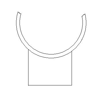

Why dont you cut down a tee joint just above half way, you should be able to push the mag on and it should clip in. The too should connect to your barrel piece.
- side view of a tee
- clip holder.jpg (7.44 KiB) Viewed 9775 times

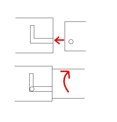

I know how you could lock it on,
on the magazine, on an area that would slip into the "mag well", put a bolt in, and in the "mag well" carve a groove, that turns to a 90 degree angle, so you align the bolt with the groove, slide it in, then rotate it to lock it in.
- maggazine.JPG (9.11 KiB) Viewed 9761 times

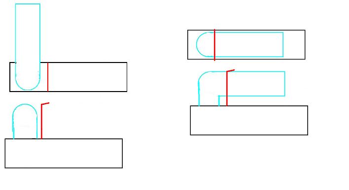

The attached picture is terrible, but I will do my best to explain it. There is a "L" shaped metal rod attached just forward of the mag hole close to the trigger and pointing away from the trigger. to load a mag, you would push the 90 elbow into the hole with the mag perpendicular to the barrel. you would then rotate the mag 90 degrees until it is parallel.
- MAG.JPG (15.37 KiB) Viewed 9736 times

jor2daje - your tee idea is probably the easiest of all the designs mentioned and i like it a lot my only concern is will the pressure in the mag while the gun is firing force the mag out of the tee?
sputnick- this seems like the most plausible design to me my only concern is how to keep the bbs in the mag while the mag isnt in the gun and during the reloading process, any ideas?
ramses - i understand the design and was considering a similar one earlier but could not find the appropriate materials to construct it, if i were to use it i have a feeling i would need to get the tolerances just right or i would not get a good seal on the mag and the gun would have poor preformance

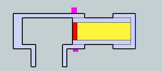

I have an idea, but it requires the use of a tee rather than an elbow. It involves using a steel plug held in place with magnets. the magnets would need to be quite strong. depending on how tolerable leakage is, you could retain the plug by some other means.
- red=steel plug,
blue=pvc,
purple= magnets
yellow=bb's - mag 2.JPG (10 KiB) Viewed 9707 times

Don't get your hopes too high up, because with a semi-powerful spring will require an uber-strong magnet. Perhaps use a disk magnet as the plug. and square/bar magnets on the outside. I would suggest a secondary retention mechanism, just in case the magnet decides to remove itself at a time you don't want hundreds of BB's flowing all over the place... Like in your car or something...ramses your tee idea has inspired me, im working on a prototype right now
