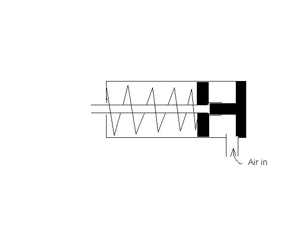

I modified the blow forward bolt a bit and set up a gravity feed system. It all works when hooked up to a blowgun and air compressor; I'd like to see the difference in performance with propane, a firing chamber, and the 1/4" QEV I ordered today.
The blow forward doesn't work perfectly, it stops and returns to the seat without traveling forward all the way and leaving about 1.5 mm of room for air to get out and blow BBs up out of the temporary magazine. It usually blows forward all the way with no spring, but won't return to the seat if there isn't a spring. If the string is too strong then it travels even less, which results in random 2 or 3 shot bursts.
Does anyone know how to fix the burst problem, while still having the bolt blow forward and re-seat itself?
How easy is it for the bolt to move? It sounds like you have too much friction in the system, ideally everything is as smooth as possibe - even if this means making it slightly loose - so you can get away with using as weak a spring as possible.
Well see the really annoying thing is that I had to take 1/2" off of the bolt because it got bent. Which means I also had to take 1/2" off the tube the bolt rides in. So the bolt travels through a tiny bit of 1" PVC and then some 1" female adapter threads. It slides fine but that might be causing the problems.

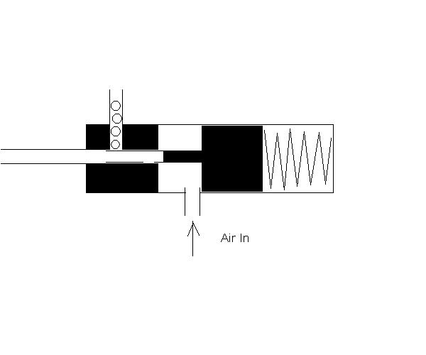

Thanks but I'm pretty sure I'll be going with my blow back. I spent today constructing it and probably around an hour screwing around with it and trying to get it to work. The bolt hasn't been blowing back but air still escapes out the barrel and magazine. So I sealed it up (I'm pretty sure) and I'll try again tomorrow.
My design is fairly simple, I'll draw it up in paint right now.

ohh I see... I can't think of any reason for it not to work... but that doesn't mean anything really
most problems surface when you go from designing to building
edit no 2
upps
I just got a closer look at the pic....it won't work... you need to make sure that mag is blocked off when air passes...
you'd need a small port cut in the tube to let ammo in (the bolt needs to have the same ID as the barrel so it has to slide inside a pipe larger than the barrel
I hope you cna understand what I mean??
