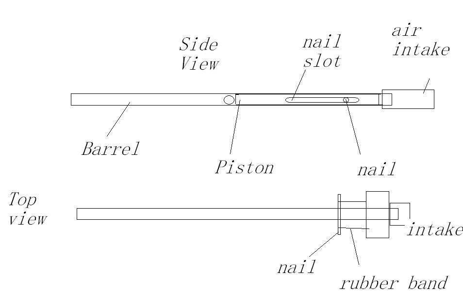

Hi, this is my first post on spudfiles and i am super excited! I was hoping to get some feedback on my newest bb gun project.
Essentially my rig works as follows:
-a 6mm ID brass pipe (12in long) from a cleaned out weed sprayer is being used as the barrel
-inside the barrel there is a piston that is blocked on one end with epoxy (piston is 4in long)
-there is a hole drilled though the side of the piston to allow a 1mm OD nail to fit though the piston
- on the both sides of the barrel there are two slots that are 2 in long and 2mm high
- then 2 rubber bands are attached to ether end of the nail that is put though the piston
-the idea is that the air pushes the piston forward and the rubber bands pull back the piston
-yesterday i ran the rig at 45psi and the performance sucked, the bb (12g 6mm) hardly went 10 feet
Am I doing something wrong? Or do i just need to take a different approach?

The biggest thing I can think of is the piston is 4 inches long. It would weigh much more than the bb, so when the entire arrangement accelerates the vast majority of the kinetic energy is used to accelerate the piston. Next on the list is the rubber bands attached to the nail through the piston. I the nail goes through sideways, to two rubber bands can attach to both ends of the nail. The total piston travel distance is only a couple inches.
As a result of high mass, low force, and short acceleration distance, the results are low velocity.
I think you need to take a different approach.

here is a diagram
bb gun 03.jpg (36.99 KiB) Viewed 2822 times

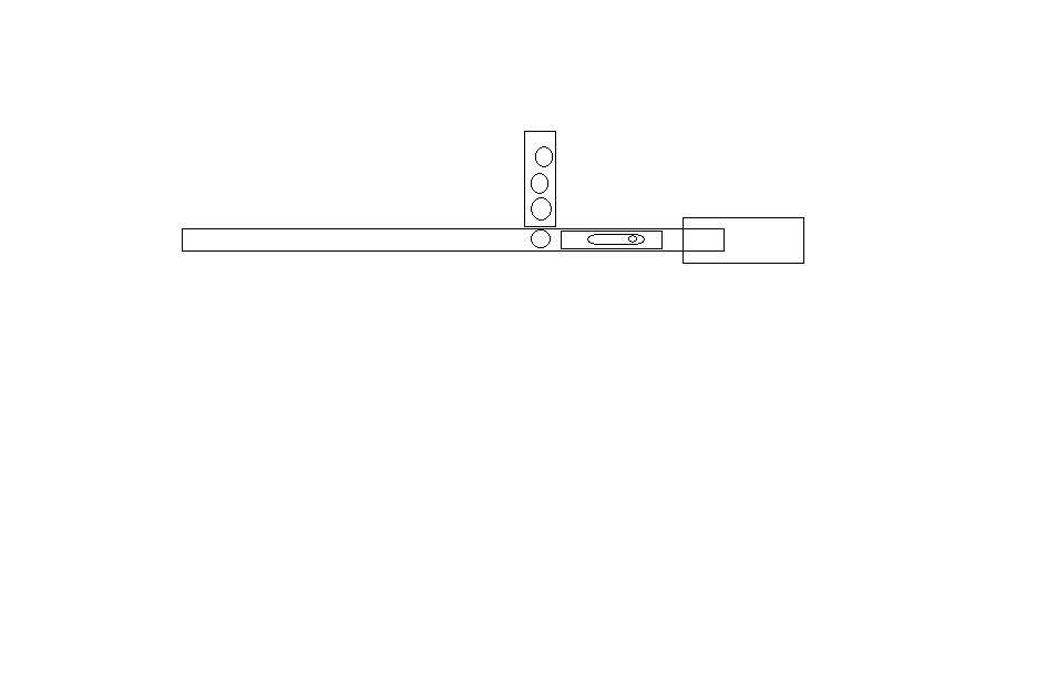

Technician1002, thanks for the advice
I think you are right in the fact that the piston is way to long. I orginaly put the rubber bands on the end of the nail, but i guess i didn't communicate that very well.
Here is my new design
bb gun 04.jpg (14.67 KiB) Viewed 2817 times

hysten wrote:Technician1002, thanks for the advice
The other problem I see with the modified design is once the piston stops, there is no air pressure behind the bb, so the rest of the time in the barrel it is trying to pull a vacuum behind it. Performance may improve if the barrel is simply cut off at the end of piston travel or air holes are provided along the barrel to use the barrel for a projectile guide. There is no further acceleration in the barrel after the piston stops.
Sat Sep 26, 2009 2:10 pm
You're using a 12 inch barrel at 45 psi, performance isn't going to be spectacular.
Here's what's possible with 0.12g BBs pushed by 300-400 psi in a barrel 3 times the length of yours ;)
