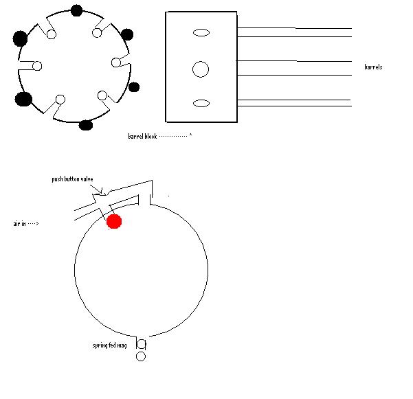

I have a reasonable idea for the loading and air delivery system. Unfortunately, I am at the library without my CAD program, and with hypersensitive mouse, but I hope the diagram is understandable.
- sorry!
- gatling gun idea.JPG (22.42 KiB) Viewed 8011 times

i'm sorry rames but i don't understand your sketch
what are the black and white dots in part the high left part ?

sorry, black would be some kind of nub to push a valve, and white would be looking down the barrel.
on the top left, the white circles and ovals would be a port to the barrel at a 90 degree angle for the bb or air to enter through.
