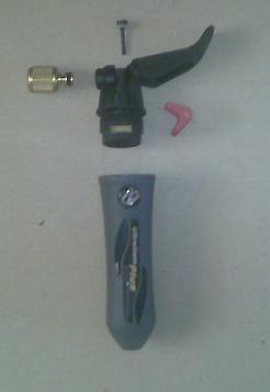

As far as I know they give the full pressure, I took apart my ultraflate and it looks like a simple sprung ball pushed down by a pin, no sign of any regulation.

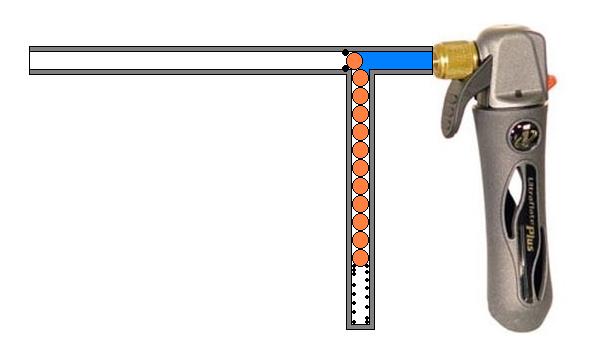

I think the easiest possible solution that gives good performance would be to combine an inflator with a tee breech. The lowish flow rate of the inflator would be negated by the seal/detent that would hold the BB in until a certain pressure was reached at that point if would be the equivalent of a burst disk valve. Not sure if you have airsoft magazines avalable but I reckon Davidvaini had the right idea :) not to mention you technically have the option of full auto as long as the trigger is pulled.

Time to put my money where my mouth is, I'm should give the inflator + tee breech a go :)

I'm giving it a whirl as we speak, will post when I have something worthwhile.

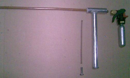

Here's a preview of the prototype for this idea curing, it's all pretty ghetto but as just a proof of concept prototype, it "only" has to work :P :wink:

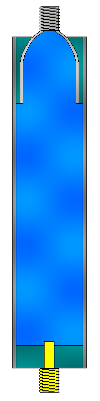

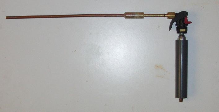

I'm also making an extended chamber with a schrader fill valve and half a used CO<sub>2</sub> bulb so there's extra air capacity and I don't have to spend money on cartridges in the off chance that it works ;)
