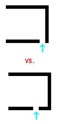

I'm working on my first vortex cap BBMG (thanks to DavidVaini for the awesome alternative to the conventional design) but I have a quick question to ask before I begin drilling the holes.
One end of a vortex cap is closed off, naturally, and my question was whether or not it would be better to put the barrel and input holes directly next to the wall rather than toward the center of the cap with some space between the holes and the wall.
In case my question wasn't worded clearly, I made a quick picture to hopefully explain it better.
Thanks for the help

well I put mine directly next to the wall and it works great.
I can't imagine it would make any particular difference.
