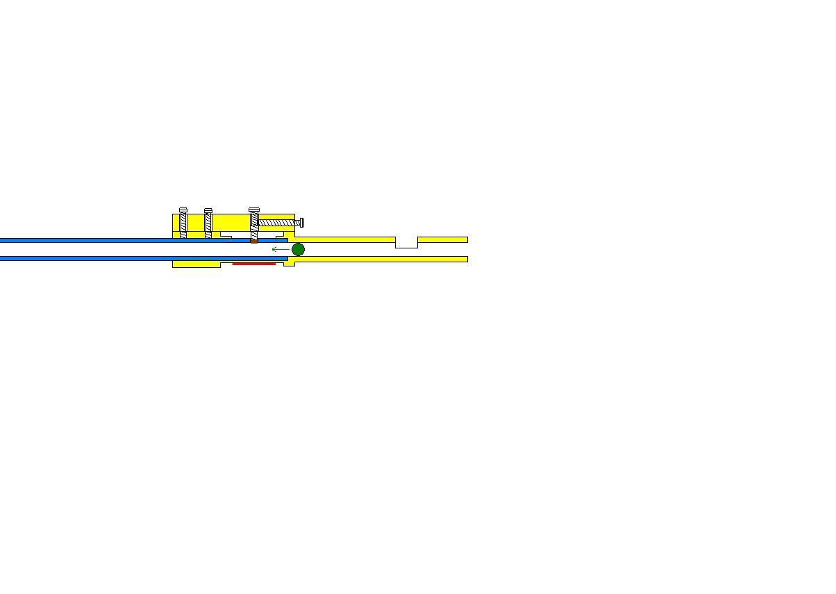

So then will it really be a problem to make a solid enough hop-up? I plan to use a screw that would push on an heat-shrink around the barrel.
I will post a schematic.
Demon
Posts: 743
Joined: Sun Apr 13, 2008 8:46 am
Wed Feb 03, 2010 4:07 pm
double post
The blue is 6.04 barrel
The yellow is home machined out of aluminium
the red is heat shrink shrinked to the barrel( maybe also glued )
The screws are 8-32
Hop-Up
Hop-Up

with the heavier BB, more force is put upon the hopup.
Heavier BB and higher power means you need a harder type bucking. This means more of a rigid ruber than a lose rubber.
With the hopup combo used in those kinds of tests, you will actually see more accuracy in the lighter weight BB.
Heavier BB of the same size will always have the potential to be more accurate, its just in a lot of cases of aftermarket hopup units and parts it isnt the case.
hope that helps.

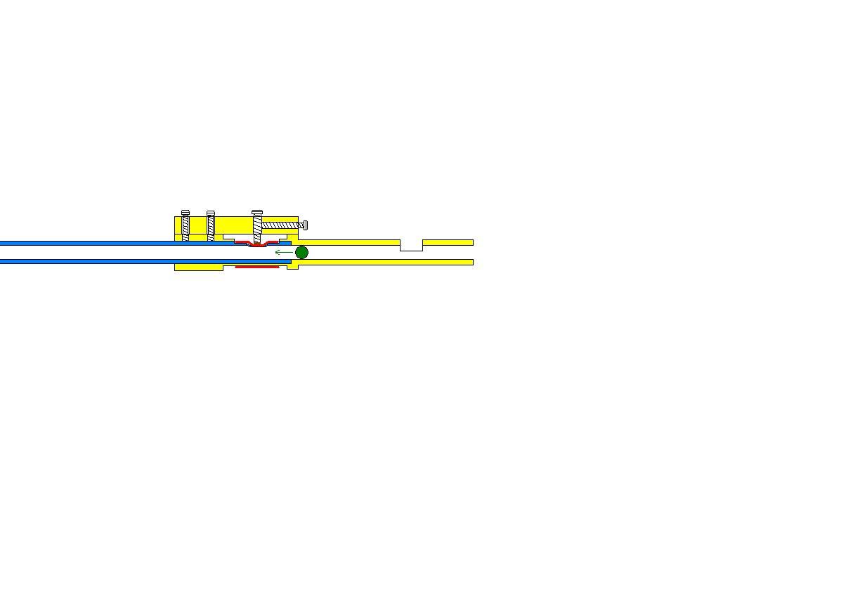

So what about this one ? The 8 -32 screw with the rubber at one end would seal with teflon tape and the casing would be hot glued to stop leaks.
Would a plastic or aluminium hop-up be a good idea?

Either should work. It mostly depends on the type of rubber you use. Have you ever seen a stock commercial hopup? they're not exactly beefy...
