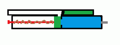

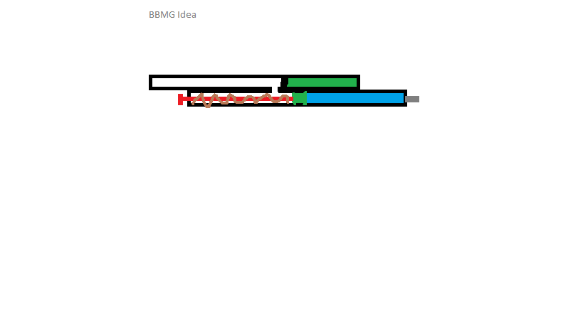

Well heres a BBMG idea I came up with the other day. Im pretty sure it would work a a semi auto gun. It works by air pressure coming through a schrader valve and building up pressure until it pushes a spring loaded epoxy piston forward past a hole to the barrel. The only problem is what kind of mag to attach and Im not sure if it will cycle automatic. Also Im not sure about the piston seal.

Thu Feb 11, 2010 10:11 pm
it's exactly the same as one of JSR's prototype that didn't work
the problem is that the piston would be pushed past the hole and would stay there slowly letting air to leak out

Oh it is,I hadn't seen that but if I used a stronger spring and lower pressures would the pressure build pust it back and the strong spring return it back
Fri Feb 12, 2010 12:12 am
clemsonguy1125 wrote:If I used a stronger spring and lower pressures would the pressure build pust it back and the strong spring return it back
No, as POLAND_SPUD pointed out essentially what you'd make is a farting machine, or an angry wasp that cycles too fast to be useful.
If you want it to have any chance of working you have to introduce a pop-off element that will allow pressure buildup then piston movement - my work in this area is well documented - essentially it should look something like this:
Ok Ill give this a shot but might end up using it in a semi auto pellet gun
