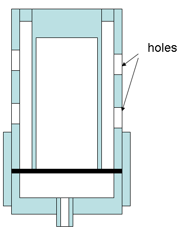

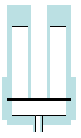

hey since you need this to seal pretty well why don't you try a diaphragm, this way you don't have to machine o-ring grooves, it will also help make the device lighter which will make it safer to drop and throw
- if you make the diaphragm seal really well with extra silicon and rubber based glues, then you can use a chamber sealing design for better dispersion

WOW
after I read some of Hubbs posts I was just contemplating how to do a diaphragm while I was on my morning run... and here you post this!! you guys are freaking geniuses I swear

The problem with the 2nd design is t that it would be incredibly challenging to fill with powder, and keep from leaking powder, when at rest.
With the 1st one, you could make a little friction fit in cap, that slides into the "barrel" that is designed to disperse the powder evenly.
Also, with both of those, you will need a one way valve equalization hole in the diaphragm. Not impossible, but challenging.

well, i gave it a shot today... it was ugly, but it was just a proof of concept... and it failed lol. I tried to base it off of the second diagram that iknowmy2tables posted... i took pictures so ill upload those once i can find my camera cable and let those do the talking...

yeah a chamber sealing piston is really tricky, the diaphragm has to be thicker and it has to seal perfectly around the edges while in a barrel sealing piston it doesn't, I'm looking forward to seeing this
