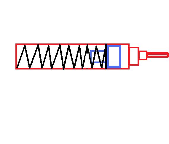

ok guys! so i wanna make a spring airsoft gun and im having problems with how to cock the gun and a trigger set up .
all i can think of is a rod too pull back the spring but i want to make is much more like pull back loading system.
(not lathes or any kind of crafting tool. :'( so it would help if i could make the parts easy to build)
thanks.
the chamber i could think off..:(

[edit] but i still need a way to like cock the gun.. :(

Anyway, I don't see anything here that says airguns are banned. You should be fine. As for cocking the piston, you could try using a one piece trigger and sear with a tab on the piston to engage the sear, and have the piston tube slide rearward inside the gun to pull back the piston. As for ease of build, you will need tools. You really can't get around it. A hacksaw and a file is the bare minimum you will need, but a dremel and a drill will make it far easier.
The vast majority of airsoft guns in this forum use no moving parts, and use either a vortex block or a cloud chamber (look those up on the wiki), reason being that small parts are very difficult to work with. Good luck though.

lol~ thanks gus. but im thinking of how big the chamber with the plunger has too be . and @SEAKING9006 wont the performance go down if there are two slits on the sides of the inner chamber?

No, it shouldn't. Take a look at the clear plastic spring pistols next time you go to walmart. Nearly every production uses thish scheme. The sear catch is near the rear of the piston, and the piston tube doesn't need to move far to engage it. There would only be one slit, behind the sealing face of the piston so it wouldn't affect performance in the least.
I'd suggest researching this further before you build anything.
