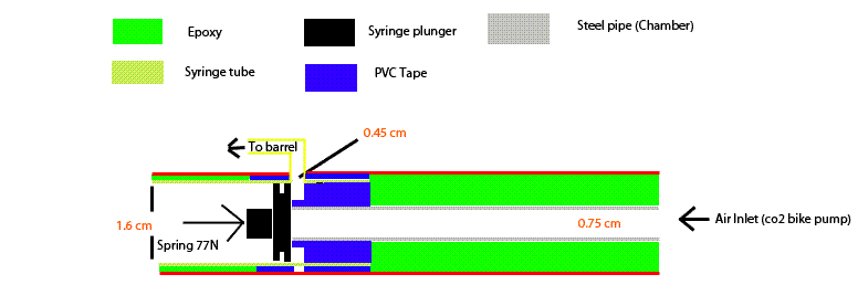

EDIT 2 July 2010- Today I've started making the popoff valve. I'm using a 1.6cm inner diameter syringe as the piston, and a 0.75cm inner diameter steel pipe for the chamber. The chamber will be 6 cm long with the air inlet on the right.
<img src="http://img194.imageshack.us/img194/149/95296582.gif">
PVC tape is wrapped around tubes to make them fit into others and allow them to be glued and epoxied.
I forgot to notate that the red is 1/2 inch pvc pipe.
So this should be done tomorrow and then I've gotta figure out the mould for the thompson body cast.

So I went ahead and made myself what I hoped to be an autovalve- what I got was not even a farter- All it did was piss out gas in a very provocative way- almost like it was saying "Fuck you I'm just not going to work now go home you lose."
Well, If at first you don't succeed...
Seriously, I don't get why the gas just freaking pissed out, but I'm not going to remake it with the same parts. I'm going to make an epoxy piston in 1/2 inch pvc with bath plug rubber on the end to seal. It will hopefully be similar to JSR's V2.

I like the diagram, I wonder if an air cushion could be used instead of a spring? It would be eaiser to adjust the fired rate by adjusting the air spring pressure.
Fri Jul 02, 2010 8:35 pm
If built exactly as in your diagram, the valve will "hang" and you will have nothing but an amusing farting machine. The piston seat area should look something like the diagram below, with the outlet exposed the instand the piston begins to move. Since more air is coming in than can come out (hence piston seat area>outlet area) there will still be an overpressure that causes the piston to pop.

jackssmirkingrevenge wrote:If built exactly as in your diagram, the valve will "hang" and you will have nothing but an amusing farting machine.

You also need to restrict the flow at the end inlet of the chamber. As small as possible, or the valve won't cycle properly.

Ok, I will change it so that the steel pipe goes a bit further in and makes that gap you're talking about, thanks for the advise.

Ranger wrote:I like the diagram, I wonder if an air cushion could be used instead of a spring? It would be eaiser to adjust the fired rate by adjusting the air spring pressure.
Precisely what I did here, but I think a coil spring is less of a headache and stil ladjustable with a screw or shim system.
Using a pump like the one below inlet flow can be adjusted appropriately, and important feature if you want to be able to control rate of fire.
Try not to leave too much dead space though as this will reduce power. Remember:

Mu CO2 pump is a genuine innovations air chuck, and I can open it as little or as much as I like.
I am trying to reduce the dead volume as much as possible by placing the gas outlet as far to the left as possible to reduce the amount of pipe travel I will need to get the gas to the barrel.
