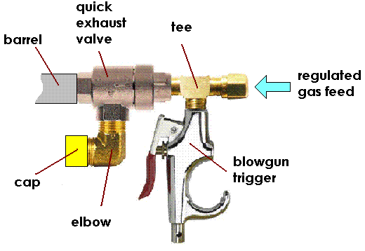

Here's a pui budget option

that would work JSR, but the reason that i wanted the three way valve was so that no air would leak out when i held down the trigger. with that method, if i pulled the trigger, air would flow out of the gas feed, and that would waste air (which is important to me because i dont have a HP system that i can use)

Standard blowguns can be modified into 3 way valves.

Gun Freak wrote:Standard blowguns can be modified into 3 way valves.
thanks, i found a thread here on how to do a pretty simple mod that will work fine for piloting a QEV. sorry for all the (newbie) questions ive been asking, uve been a great help

Have you considered a "valveless/pop-off" system? You'd get no air wastage whatsoever and all you'd need is a blowgun ;)
