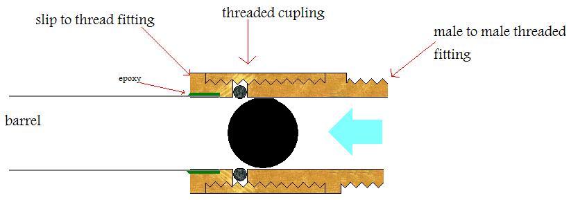

As to mounting the o-rings, you need to sandwich it between a threaded fitting, something like this:

The good thing about having the o-ring in a threaded fitting though is that pop-off pressure increases as you tighten it, so there is some level of adjustability.

You can do it with part you can buy from the hardware store, a few fittings would need to be modded, slip to thread fitting need the end drilled to fitting the OD of barrel and the coupling cut down so the two male fittings can bottom out
I would use PVC parts because they have thicker walls that will give more area for the O-ring.
