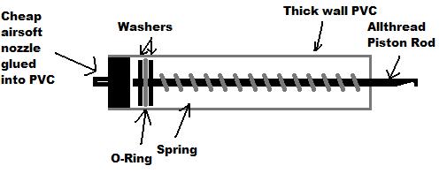

I was recently working on a airsoft bolt action sniper, and ran across a fabrication problem. As you can see, the piston is exactly like those found in commercial airsoft springers. The entire piston cylinder is pulled back, until the piston rod catches on a sear. Then the cylinder is moved back to the barrel. The piston rod is then released, leaping forward and creating a quick, high pressure burst of air which propels the BB. So far so good.
My problem was coming up with a case for the entire assembly.
I had intended to place the 3/4 inch PVC cylinder inside a slightly larger pipe with a slot in the side for the charging handle. Unfortunately, I was unable to find a pipe with an inside diameter of the correct size.
Any idea's on creating a case for this?
I thought of a block of something (steel, aluminum, wood, epoxy) with appropriate sized holes bored through, but I lack the tools to do a really good job of it. The problem is that the nozzle has to end up in a very specific place each time, and any variation could cause rapid wear.
