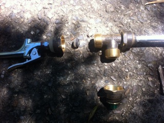

Wed Nov 06, 2013 2:19 am
Should the piton protrude into the chamber behind it ? If you can see here there is a gap from on chamber to the next!

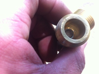

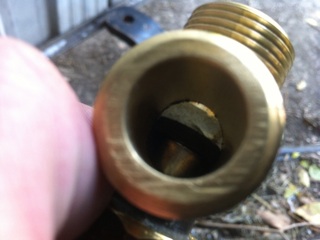

Wed Nov 06, 2013 4:12 am
Should the piston protrude into the chamber behind it ? If you can see here there is a gap from on chamber to the next!
Wed Nov 06, 2013 5:55 am
Looks OK to me.

Wed Nov 06, 2013 7:02 am
One thing, is the face where the piston touches rough with sharp edges? This can compromise sealing and damage your piston seal.

Thu Nov 07, 2013 1:25 am
Nah,no sharp edges I've filed the barrel flat with a fine file and taken the rough edge off,I'm using a nylon washer as a seal,that should be ok yeah?
Labtecpower
Posts: 1297
Location: Pyongyang
Has thanked: 5 times
Been thanked: 13 times
Thu Nov 07, 2013 3:11 am
I don't think filing the barrel flat will do, especially with hard seals like yours. With a nylon seal the barrel needs to be absolutely straight, as there's not much deformation on the seal to close gaps. You'll have better luck with a rubber washer.
