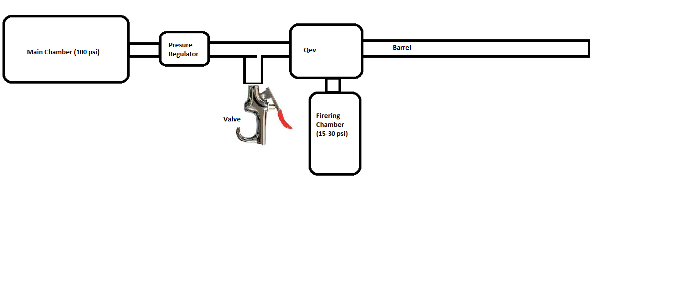

Hey people,
I was wandering if anyone could reply some sujjestions about this design.
And would it work well with about 5mm balll bearings.
Please comment I haven't made many air guns and would like information
Thanks
Multi Shot 3.png (35.73 KiB) Viewed 7667 times

Mon Apr 14, 2014 5:27 am
Replace the blowgun valve is a slide valve.
30 psi is not going to give you a lot of power, it will be equivalent to an airsoft gun.

Thanks,
How much pressure should I have for ball bearing to get good power with a medium size air tank
Tue Apr 15, 2014 4:28 am
use this -> http://www.thehalls-in-bfe.com/GGDT/
Use search function to find out how to use it

Sat Jan 09, 2016 6:15 pm
I tried this set up and it just blew out of the air blower and didnt release or transfer air to the barrel. ..why how would you fix that?
Sun Jan 10, 2016 9:26 am
TargetOz wrote:I tried this set up and it just blew out of the air blower and didnt release or transfer air to the barrel. ..why how would you fix that?
Your piston is probably not tight enough.

Thu Mar 31, 2016 11:35 pm
The problem is you haven't made many air guns as you say.
Play around with your creativity to achieve what you want to achieve. I stay away from QEV's as they dump high pressure air into the open, when I could be using that air elsewhere.
