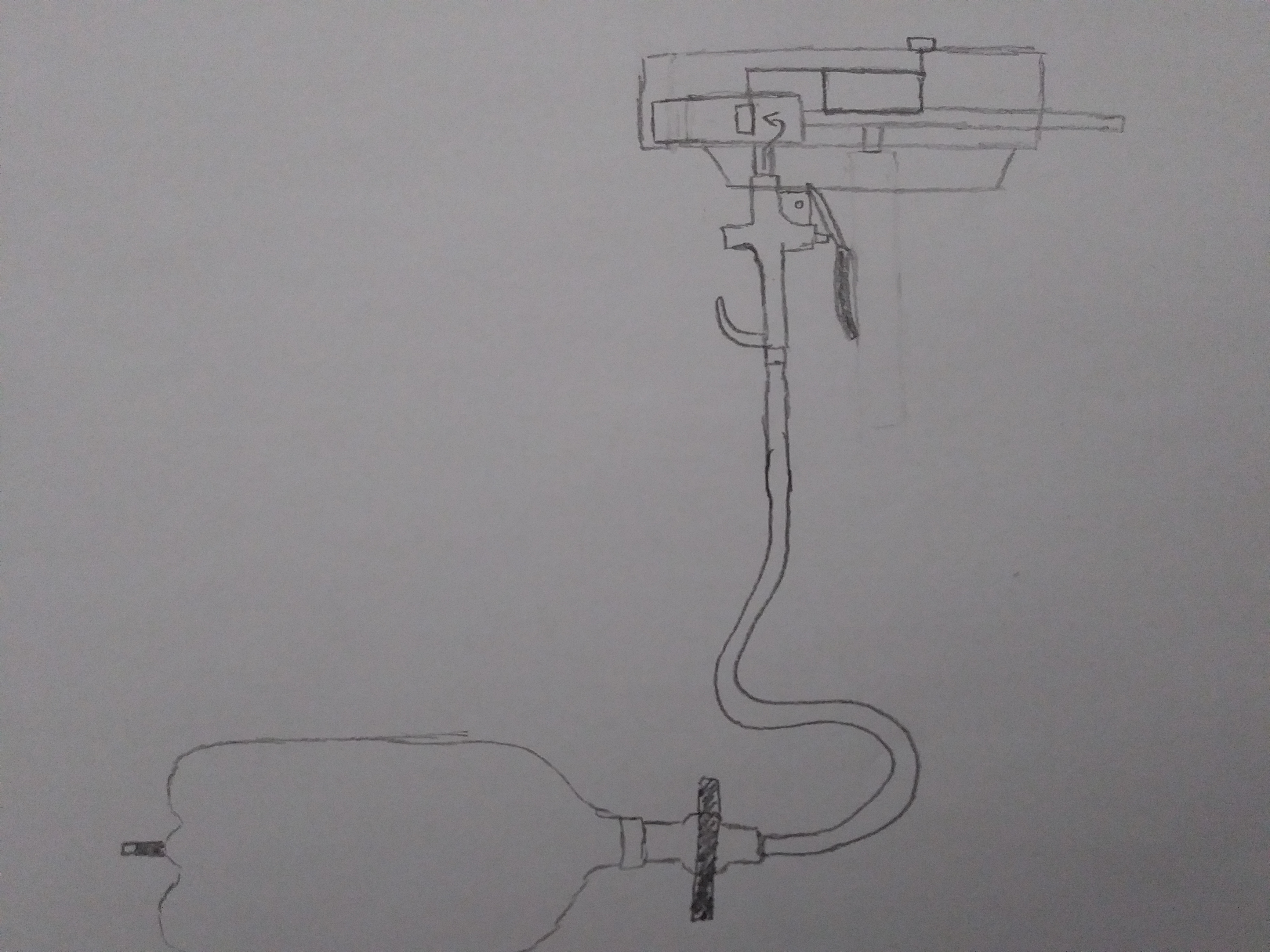

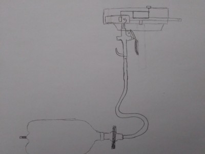

Here's a quick sketch at what I'm aiming for. I also went ahead and drew the custom airtank( modeled after a commercial one) that I made out of a soda bottle ( the large ones), a ball valve , an air tube, and a threaded end with an o ring attached for the Blowgun. So essentially its like how I described, when the air shoots out the Blowgun the blowback engine would go back and forth like the actual one. So anyways anyone got tips for making it work?
Also thanks for the bike pump answer
