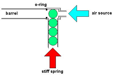

Thu Aug 09, 2007 10:03 pm
Instead of a complicated feed, why not try something like this? The pressure should fire the shot in the barrel and if the mag tube is of the same calibre, it will keep the other rounds from exiting.

Thu Aug 09, 2007 10:31 pm
Th only reason I haven't tried a feed system like that is because my barrel runs through the tee, so my barrel actually has a hole in it. I guess I could cut off the drilled out portion, but I would lose power.
