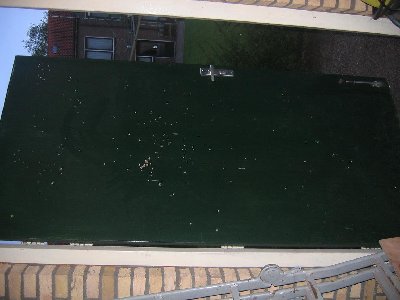

I'd never shoot at my compressor.. it seems to be kinda dangerous.. and a waste and stuff.. allthough i did accedentally desroy my door with a bb shotgun blast... or 3.. ..
