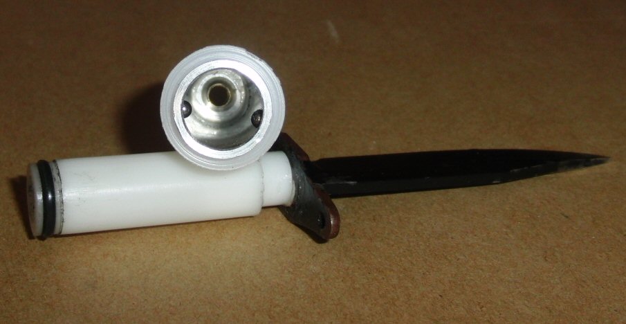

Following a discussing in the knife thread, decided to put a little prototype together.
Concept:
Here it is in action at 300 psi in real time, 420 frames per second and 1000 frames per second:
The knife blade is from a cheap little made-in-Taiwan knife, the rest of it is in Delrin. Chamber is an aluminium tube with a Delrin collar and 3mm steel bearings as a detent.
Some photos:
close up of the detent in the closed position
Firing sequence and internal details
knife and chamber
knife and chamber

I'd be interested to know at what pressure the ring fails.
Interestingly this is one occasion where slow motion does not make it look cooler :D
al-xg wrote:I'd be interested to know at what pressure the ring fails.
I made it out of Delrin because it's so easy to work with, seems ok at 300 psi. I'll take it higher after I'm sure the epoxy is fully cured.

Nice job! Are you going to try a higher pressure when the epoxy has fully cured? If so, I may try making one of these.
Took it to 400 psi and the shoulder on the "handle" which comes into contact with the detent deformed and released the knife. A brass collar would have been a good idea :)
One other thing worth noting, the collar is extremely difficult to push forward past 350 psi.
