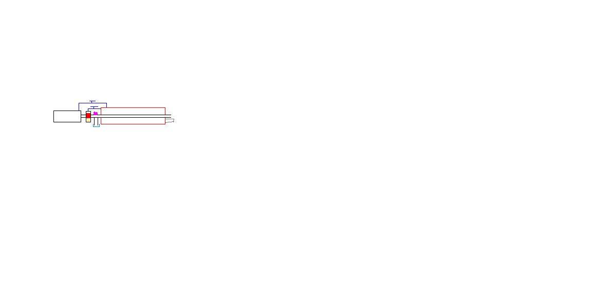

I just quickly drew this up. He already has a semi auto *small* gun.ALIHISGREAT wrote:nahhh thats too easy for the pen-gun-king... i challenge you to make a semi auto self contained pen gunIn the meantime, I'm working on the marker project I had thought up a while ago(ha i'd like to see that done!)
The idea of this is it has 2 chambers, a large pressure chamber and a smaller firing chamber. The small firing chamber is repressurised after each shot by the large chamber (using a valve - good luck getting one small enough though. Perhaps a small sprinkler valve?). The magazine would hold few bb's to try keep with a pen/marker shape. After it is refilled it can be capped off. It is gravity fed, with a magnet to hold the bb until firing. The firing valve is basically a piston which blocks the barrel, and when a valve is opened from the larger tank air presses the piston down (which is sprung) allowing the chamber pressure to go through, firing the gun. Releasing the pilot pressure from the main tank closes the valve, allowing the weapon to be re-pressurised. BTW the pressure chamber is over the barrel like a co-ax but is separated.
With a lathe you could probably build it to fit a large-ish marker.
I guess it could be adapted to use a co-ax type setup instead of the piston valve.
Good luck if you try it, and I like the look of the marker gun.
- Multi shot mini design
- semi auto mini.JPG (13.67 KiB) Viewed 11892 times
Semi auto is impractical on such a small scale (unless you conjure up a tiny hammer valve in order to conserve pressure reserves) however a burst fire pen gun in this vein but firing say 2.5-3mm lead shot is very do-able, hmmm...
