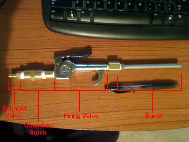

c11man, thanks for pointing out that the tests were done with a combustion cannon, i didn't notice that. :? Thanks also for the chamber info. As for the revised version, the chamber was the "stock" of the gun since i thought the chamber had to be that small.
I've redesigned... once again... because I was making it way more complex than it had to be. I threw out the idea of making a piston valve, started from scratch, and this is what I came up with. Thanks to c11man's info on the bigger the chamber, the better for pneumatics, I'll have to make a bigger chamber.
Let me know what you think, and remember, that isn't the final chamber.

That's more like it, get yourself a shock pump and at 400 psi it should be pretty impressive for its size.

yeah c11man is right, it's for combustions
also he is right that you might have used a larger chamber... your first chamber was too large but this one could be slightly larger... you should be fine with a 3" length of 1/2" pipe... esspecially if you want to use a longer barrel
of course it's completely up to you and the source of air that you have
I have to admit that in the past I was a big fan of c:b ratios smaller than 1:1... normally they were lower than 0.5:1
but now that I have a fridge compressor with a tank I don't mind using ratios close to 2:1 especially on a small bore launchers that don't use much air anyway

Excellent, shouldn't be hard to find a good one for not much $$$. You might want to move to a longer barrel in future too, it will make a considerable difference in power.
