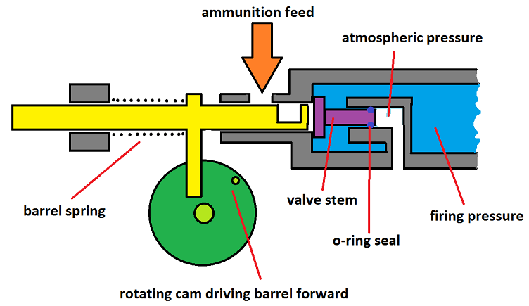

I have done some ratatatata experiments...
I think your electric drive is a good idea for what you want, I think it can be optimized though.
This is how I would do it:
The dead space is reduced and I have made the valve stem "balanced", this means most of its area does not have the full pressure from the firing chamber and therefore you need a much weaker spring to knock it open, this means you can use a smaller, lighter motor with lower electricity consumption.

Thanks you for drawing balanced valve ! I understood
Great, I think it would be worth incorporating into your next prototype. You can make a gun that is technically interesting as well as efficient and lightweight :)

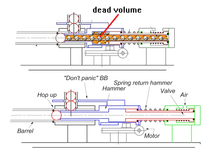

Hello
Here is the drawing of my next project!
Maybe one or two errors, but I think I got what I want .... :idea:
- Large valve opening
- Direct injection
- Balanced valve (I think so) :scratch:
- No containment (I hope) :bounce:
- and Injection just after stuffing the ball on the hop up, the reverse thing my first gun.....
(I hope my Chinglish is sufficiently understandable!)

A bit convoluted but it looks like it would work :) The small spring next to the air input needs to be finely tuned in order to counterbalance the pressure. Too little force and it will leak, too much force and it will need too much hammer strength to open.
One thing you have to be careful about is "dead volume", I marked it below and compressed the design to reduce it:
More dead volume means the air has more time to expand and lose pressure before pushing the BB, so it will decrease efficiency.

I am well aware that the dead volume is detrimental to the operation! and I will try to improve the concept...
But this drawing is the first jet (or first rush)to define the movements and shapes...
soon pictures of the first pièces, after changing the drawing, :bounce:
PS : Thanks for drawing !! :wink:
