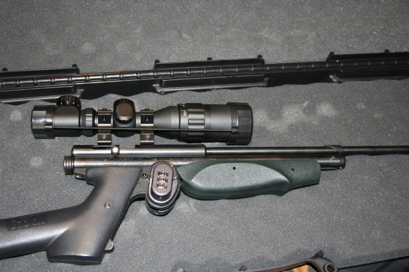

Interesting, no doubt about it.
But the cost of the tap would exceed the amount I spend on cartridges for a year.( there are a 1077 and a 357-8 in the cabinet)
Following Marks build up of his 1377, got me "fired up", and I modded my old 1322.
I pretty much use it exclusively now.

p.s. thats a cool air rifle

Backpacker airgun cool.http://www.canadiantire.ca/browse/produ ... earch=true You ever use it like a pistol? You must not buy too many cartidges then, exspencive for such a small ammount. Wouldn't your work have the taps? EDIT: Btw This is the pistol I am looking at getting walther ppk/s airpistol http://www.z-shops.eu/images/Walther%20 ... dvbgfb.jpg

And thanks, it's a fun project, and one of my more practical ones. Still a few pieces to change out/make, but it's getting there.
