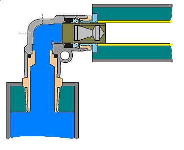

I'm assuing this is what they look like inside:
Doesn't look like it can be readily adapted to hold a projectile in a reliable and airtight manner...

I don't think this particular "detent triggered" design is ideal for full auto, unless you are cycling it externally as I had proposed here.
For full auto, the ideal would be to have a sealed breech that will only release the projectile at a given pressure and reset instantly - something like this with an airtight seal - and the cycle would be as follows:
1 - Air feed valve to projectile chamber opened
2 - Projectile moves to breech and is held by seal
3 - Pressure builds up in the chamber until the projectile is released
The next projectile then moves to the breech and the cycle is repeated until the air feed is closed or projectiles run out.
The only way I see the "detent triggered" design work as semi or full auto is using cartridges, maybe looking like this. The issue is that they're a bit complex to produce in bulk without machining facilities.
