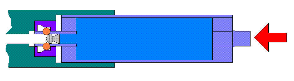

but I still think it isn't very practical.... though I really like your idea to use a QC to build valves launcher... I think it could be coupled with a simple pressure dependant loading mechanism
A "valveless" cartridge on QC principles as illustrated below is certainly within my construction capabilities, the pellet skirt would take care of sealing - but I doubt i would be able to make it in the quantities required of a practical cartridge launcher. Maybe the lathe-owning crew could turn it into a feasible proposition ;)

The diagram you posted is... hard to do unless pellets can seal.
The orange balls...
If they are balls from a QC, then it won't seal, unless the skirt of the pellet seals.
If they are an o-ring, then the piece of pipe after it will be cut off.
So, can pellets seal 800 psi by the use of the skirt?
The orange balls...
Balls! Though slots cut for an o-ring could conceivably work as well, and be less likely to deform the projectile.
Never tested it that high but it sealed to 350-400 psi in this project, the pressure would bend the projectiles a little but that's because they were only held by one pin, obiously having 2 or more would alleviate this problem.

on your diagram, is grey a spacer and green epoxy?
The grey is masking tape, cut into thin strips and wrapped around the barrel/schrader until it matched the inner diameter of the chamber. The green is Araldite epoxy, with small diameters even this "ordinary" epoxy is enough to cope with high pressures.
