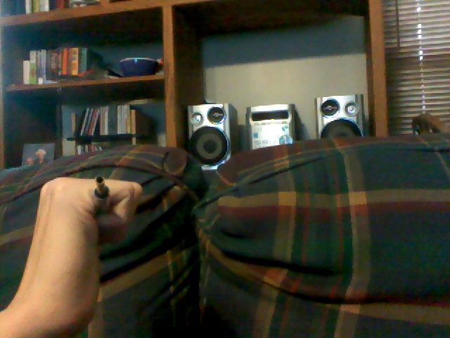

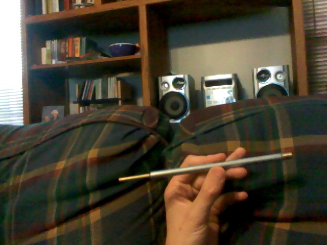

After seeing the multitude of pen guns posted in the last few weeks I decided to try building one. Right now all testing is done at 80-100PSI until I get my shock pump, then Ill up the pressure. The video below is a 80 PSI shot with a small nail at a Pepsi can.
Chamber-7.14mm Brakeline
Fill-Schrader
Pilot-Schrader
Piston-a piece of a rubber spongebob key chain
Power-Shot a toothpick across the room at 150 PSI

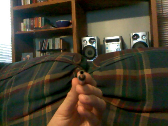

Looks good but I would've liked to see the piston before it went in. Awaiting damage...

Its similair to JSRs. just a piece of rubber punched out with a piece of the chamber, ill test it later, if it doesnt work, ill toss it into my bucket of failed minis

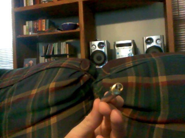

Did you get a threaded schrader or is it a normal one just epoxied in?

I bought a normal one, put it i my drill and held a file to it until all the rubber had be shaved off, than roughed it up a little so the epoxy would bond to it

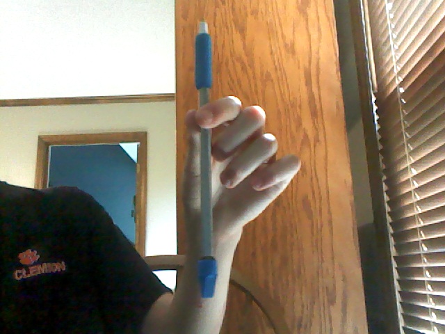

No problem spud blaster, thanks for the tip, BTW I added a picture of the gun with its grip, and eraser cap

Looks very nice clemonsguy, how did you end up spacing the barrel from the chamber?
