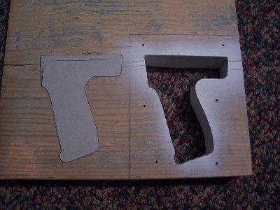

Here's a few pics from my weekend project. I wanted a custom pistol grip for a shoulder fired launcher im building so i tried bondo. It's pretty hefty and solid. I wont know how well it holds up until i get the gun finished and shoot it a few times. It's about 1 inch thick. Cost about $5 bucks to make. It took a full (small) can of bondo.

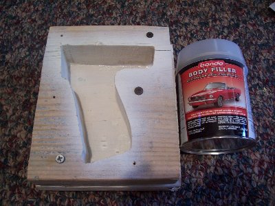

Cut out a cardboard pattern and trace it onto a 2" board and cut out the area with a jig saw. Spray paint the inside to fill in the grain.
I used silicone around the bottom crack where the 2 boards meet but its not necessary. I also sprayed the entire area with non stick cooking oil.

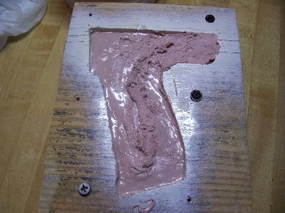

Mix the bondo and remember you only have a couple minutes before it starts to kick up so mix and pour fast but mix it good.
Be sure to poke around all over to get out the air bubbles.

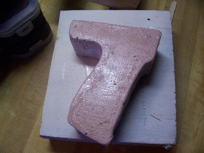

I seperated the mold after about an hour.
It slid out of the mold fairly easy.

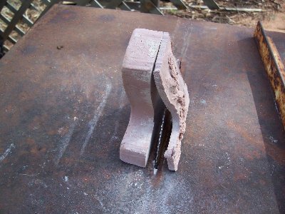

I used my homemade table saw to trim down the width.

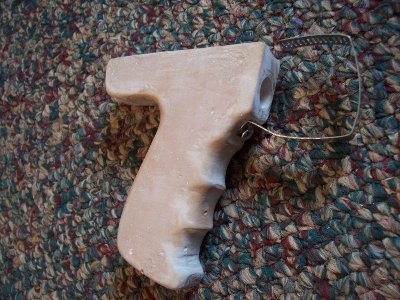

After alot of filing and sanding. Do Not breathe the dust when you sand bondo. I drilled the bbq igniter hole with a drill press.

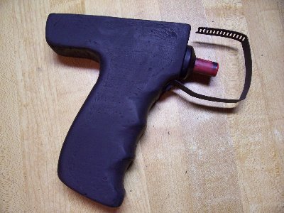

Finished. of course you need to figure out how you want to attach it, i drilled a slot for a hose clamp (not pictured).
