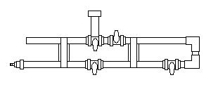

I had an idea for a cannon that should be able to fire 3 shots semi-auto. It has one large pressure chamber (about 90 cm of 1" pipe), with three ball valves placed at regular intervals (about 30 cm). And a schrader valve at one end of the chamber and a two right angle fittings leading up to the barrel, which is about 30 cm of 1" pipe. The ball valve on the barrel is Fiveseven's design:
http://www.spudfiles.com/forums/viewtopic.php?t=1683&
In theory you would open the 2 ball valves closest to the schrader, fill to about 100 psi, close the two ball valves and your ready to fire 3 shots. To fire a shot first turn the loading valve once then open the first ball valve closest to the barrel, fire the next one by reloading and opening the next valve, and so on. Each shot will be the same pressure as you first pumped the gun up to, except that it will be one third the volume, the barrel is the same volume as one of the chambers to accomodate for this. I call it the M-30.
It can probably be modified into some sort of shotgun design.
The 3 shot cannon, just an idea.

As is, you have all three chambers in series, one after the other. What about making them paralell, next to eachother (instead if one after another), all directed into the same barrel? That would eliminate the problem of each shot getting sucessively weaker. Also, using this method, you could fire with a sprinkler valve, which would be much faster. Here's a very rough 5 minute Mspaint sketch of my idea:
Each pressure tank would have a schrader at the bottom. Keep the ball valves closed when pumping. To select a pressure tank to use, open it's ball valve. Then, fire the cannon with the sprinkler valve (box at the base of the barrel). Open the valve for the next pressure chamber, repeat. Try to keep dead space between the pressure chamber and the barrel as small as possibe. Keep in mind that with this design, you could also use two or even all three chambers at once for a more powerful shot, or use them one at a time. If I was going to build this design, I'd make it breech loading. This would make reloading much easier.

Pete Zaria : Each time you would want to fire a shot from your design you would need to do three things, which is not really semi auto, also im assuming that each tank would need to be filled individually. Oh, and if you want there to be a sprinkler valve instead, you can use three sprinker valves instead of the three ball valves, not including the loading one which is used for loading.

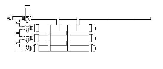

So by taking into consideration the above suggestions I have come up with a new model, the M-90.
You fill it once using the ONE schrader and close the ball valves.
Turn the loading ball valve to load a shot.
Open any one of yhe three ball valves to fire a shot.
Re-load.
Open another valve.
Saladtosser: No need for many schrader valve or check valves, it all depends where you mount the schrader.
Re-load.
Open another valve.
- The M-90

Thats alot of weight to carry around and its realy bulky,but there would be a less noticable power drop unlike your first design.But i like Pete Zaria design better and you would only need one filling spot just open all the ball valves(not the barrel venting one) and have filling point anywhere you want and with a sprinkler valve it would work fine but the loading of the ammo into the barrel would be the hardest part to make it semi auto.And i have had a few two many drinks sorry if this doesnt make complete sense.Pease out!
