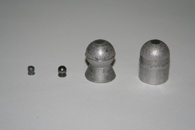

Below are a couple of slugs cast from molds I made using a 3/4" ball end router bit for the round end.
Carbide router bits also work nicely on aluminum. Use WD-40 as a coolant/lubricant to prevent galling and melting of the aluminum onto the tool edge.

Yes, they are hollow in the back. And thank you.
