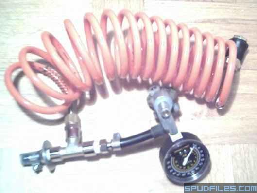

I haven't been able to get a good regulator for my CO2 setup yet (good = 300 psi out without costing $600), so I've devised a filling adapter that lets me charge the gun accurately, without subjecting anything to the full pressure of the CO2 tank. <br>
the adapter consists of a dumlop bicycle valve (one-way valve) inside a hose barb, a gauge from a busted 12V compressor and a compressor hose with a quick disconnect, all connected to a tee.

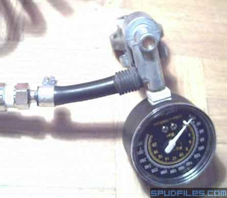

The gauge is still attached to the compressor block, since it's a bit complicated to remove.

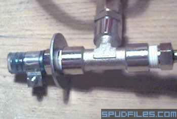

A piece of thick PVC hose is connected to the hose barb with the one-way valve.

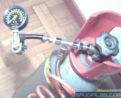

And it fits snugly inside the tank valve outlet.

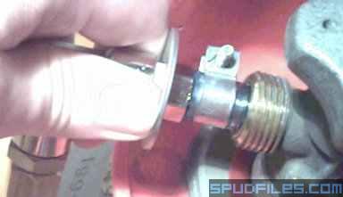

To fill the gun, the quick disconnect is connected to the inlet on the gun, and the adapter is pushed into the tank outlet. The adapter needs to be held back with greater force than the gas is exerting, the area of the outlet is 1.33 cm^2 so to fill the gun to full pressure, I need to push with a force of 27 kg (60 lbs). This ensures that I can't fill it to extreme pressures accidentally, and with the gauge I can fill it to within 10 psi of the desired pressure.
