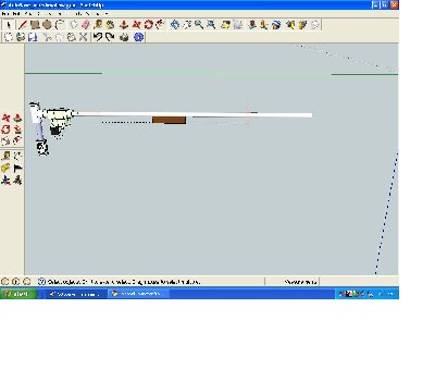

I am new to sketchup as of last night. Using model in the 3d warehouse i have partially modelled my newest creation. i am now having difficulties with sketchup.
Edit-sorry about small picture, it's understandable in full screen under zoom.

Send Dewey1 a PM. He is a whiz with Sketchup. He modeled one of my launchers in it with rectangular ports in the valve.

@Tech;
I do all my drawings in autocad and then import them into sketchup.
I am far from a whiz in sketchup.
Actually I am quicker and better in autocad.
Been using variations of autocad for 20 years.
To original poster; click on my signature for sketchup library.

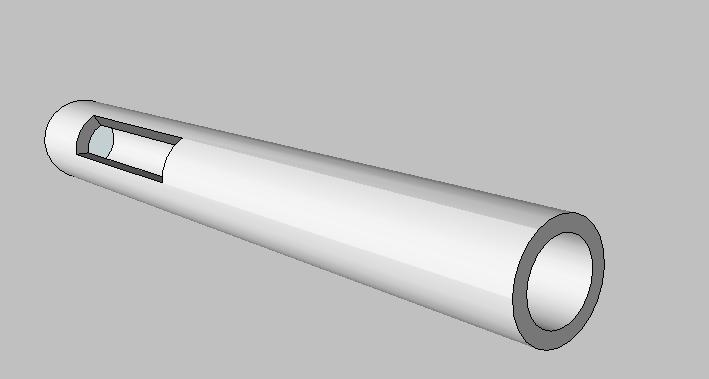

The "rectangle" ; Did you want to create a groove in it, similar to this?
- breech groove.JPG (13.42 KiB) Viewed 1997 times

I used a drill press to drill a series of holes lengthwise the pipe. I used a hacksaw go do the cuts cross the pipe. Then the sections were lifted out and then filed smooth.
I photo documented a larger cannon. The small one was made the exact same way.
The thread on the 2.5 inch build is here. It is not finished yet.
http://www.spudfiles.com/forums/2-5-inc ... 19456.html

Could have sworn I wrote this for a reason
Look a few posts down, I cover how to remove sections from curved surfaces by intersection + deleting, with a vortex block as an example. Ask here again if you need more help.
