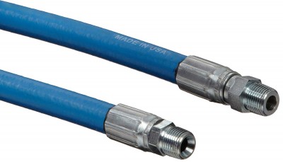

Perhaps hose for a high pressure cleaner? EDIT: These probably have some kind of proprietary fitting so that's probably not an option. There are so many guys here using fridge comps, what do you guys use to connect it to your cannons?

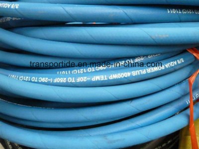

Yes, we use stuff at work rated for 3000psi, 3/8 ID single wire reinforced, it is somewhat flexible. The ends are hydraulic crimped though.
It looks like this.
It looks like this.

Yeah but i think they are sold in fixed lengths, and this tiny fridge comp is already so slow. I'm now aiming more to replace the union fittings with high pressure QD fittings, perhaps i could keep using the copper tubing that way. Any idea on what the regular DIY store QD's can handle?

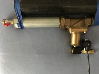

Allright thanks! I'll use a one-way female QD for the main chamber and a male side for the pilot, my fridge comp already splits into two lines so it's less of a hassle than it sounds like. The pilot is operated by a 1/4 QEV which again is piloted by a 1/4 solenoid valve so using a female QD for the pilot would not work anyway unless it's a free flowing one. Here's a pic of the basic concept:
Please don't mind the tape it's still in prototype phase

Yesh! Foster fittings are ideal for this, so if your actually building something "finished" I'd highly suggets on using them. I just wanted to point out that normal QD fittings do seem to last at higher pressures, but its always risky going over the recommended pressure limit

I'll check if i still have the right amount of cheap QD fittings lying around to complete it, it would be a waste to spend extra money on it. I'll see if i can find a paintball supply store that could supply me with both the high pressure hose and the Foster fittings. I thought that if the QD on the pilot side failed the cannon would go off on it's own, but i did not think that one through as the solenoid valve would still be in the closed position. This cannon would fire a large projectile and a counterweight of equal mass to eliminate recoil, so if that concept fails i might tear it down completely to build a new cannon. I'm not even sure if the thin duct tape-wrapped PVC barrel can even hold up to that kind of abuse... So polishing will come when the design looks promisingjakethebeast wrote:Yesh! Foster fittings are ideal for this, so if your actually building something "finished" I'd highly suggets on using them. I just wanted to point out that normal QD fittings do seem to last at higher pressures, but its always risky going over the recommended pressure limit
