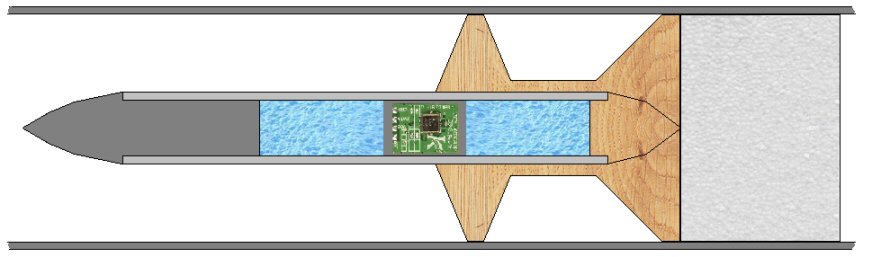

I'm thinking of something like the diagram attached, as to tracking beacons there are resources to make your own (assuming the light/acoustic beacon is unsuitable) and a GPS tracker (requiring a SIM card but nothing else) can be purchased for less than $75 though it would be a little bulky. Good instructable article for a radio beacon here.
I would advocate full bore fins, each with two contact points in the barrel to ensure stability without too much friction, because it would allow the sabot to be a simple cylinder that doesn't need to be too elaborate.
The beacon would be placed between layers of foam or any similar damping material to reduce the shock of firing and impact.

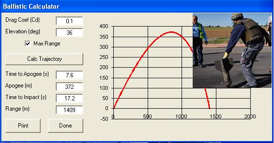

Can some smart people weigh in on the likely hood of a TallBoy shaped projectile making it as far as 2km?
Assuming a muzzle velocity of 700 feet per second, this is what GGDT predicted for a 100 gram 42.3mm diameter projectile with a drag coefficient of 0.1, just under 1.5km.

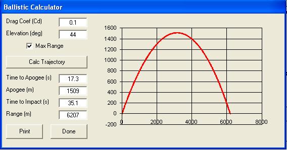

A small design exercise, I ran some numbers for a 0.25" diameter dart weighing 100g (using a tungsten core it would be shorter than a foot) fired at a very feasible (using a sabot) 850 feet per second and with an achievable C<sub>D</sub> of 0.1, and GGDT suggested a range of no less than 6207 metres - over three and a half miles! Again, it's just a virtual model, but still a sign of what might be possible.
