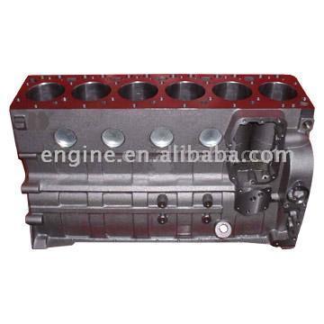

I have one problom with this.
Have you ever seen how thick cylinder walls are on a diesel engine? Everything that you have pictured are piston sleeves, which are not designed to harness all the stresses of the cumustion process, they are just a smooth surfuse for the piston rings to seal aganst.
- Notice at least an inch between cylender walls.
- Cylinder_Block_for_Deutz_F6L913.jpg (15.71 KiB) Viewed 3629 times

It is unlikely that a detonation will damage an engine block, which is at least an inch thick at it's thinnest point, but detonation is well known in the automotive world to cause severe damage to the much thinner piston.
Also, pyro, your comparison is invalidated by the fact that almost all engine blocks are made from aluminum, which responds differently to detonation forces than steel.

A cilinder from a moped is at least 0.8 cm thick.. that is alot more than sch40.
ehmm an engine block aluminium... isnt aluminium less strong than steel

2) As others have said, your pictured items are piston sleeves... if they where not supported by the engine block, they'd rupture in the same manner an unsupported case wall would rupture in a firearm. (what, you thought .01" thick brass held 60,000 psi?)

pyro: the shockwave would only act on the walls of the cylinder and the cylinder itself won't burst because that would require enough force to blast open the engine block, which CAN NOT be generated because the detonation moves the piston and releases the excess gas at the end of the stroke.

Sch 40 galvanised pipe is not even designed for heat, I do not belive that this pipe will handle a 30x mixture.
Sorry, most engine blocks are cast steel or iron. I pit drag race in the outlaw series and run an all aluminum big block which cost the guy well over $2000 just for the bare block. 95% of all V8 enines on the road are not aluminum. (maybe aluminum heads)SpudBlaster15 wrote:Also, pyro, your comparison is invalidated by the fact that almost all engine blocks are made from aluminum, which responds differently to detonation forces than steel.
