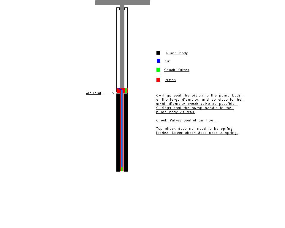

A simple 2 stage pump could be something like this.
Please excuse the fact that I neglected to colour the air in the first stage.
two stage pump.JPG (36.33 KiB) Viewed 8857 times

can you explane to me how it spouted to work i mean how the air flow. in the upper check valve or the lower and the flow way up or down. and where the high pressure air exit
and how much air pressure can i get from this 2 stage pump ?

On the "up" stroke, the air in the "low pressure" cylinder (large diameter) is compressed into the "high pressure" cylinder. (small diameter)
On the "down" stroke, air is drawn into the "low pressure" (large cylinder). The air in the small diameter "high pressure" cylinder is compressed further and sent to your gun.
The rate at which the air is compressed in each stage will depend on the diameters chosen when building the pump.
Ultimately, the maximum pressure that could be generated will be dependant on the diameter of the small piston, the cracking pressure of the check valve, and the effort you can put into it.
I hope that helps. If not, I can try again. :)

i dont get it first time but wen i know thate small diameter piston have o rings close to the chech valve i know catch the idea
but why you dont have an check valve in the air inlet there are no vacum to suck the air into the larg cylinder

The air follows this path;
Down stroke;
The air enters the pump through the inlet in the side of the pump.
The air then flows through the check valve in the large diameter portion of the piston, into the chamber.
Up stroke;
The air is compressed in the low pressure cylinder, and forced down the center of the piston, past the second check valve, and into the high pressure cylinder.
Down stroke;
The air in the high pressure cylinder is further compressed and will no go through another check valve (not shown) on the foot of the pump, and on to your "device".
Repeat. :)
