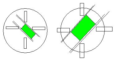

A 4-jaw chuck would let one dimension be centered at all times if you stick in 2 diagonal plates. Adjust your piece until it's at the right spot for the diameter you want, then clamp it down. The only thing that it can't do is offset in 2 dimensions, but I can't see myself ever needing to do that. In all the cases I can think of, I need the curve centered perfectly every time, and this will do it with incredible ease.
(Forgive the messy drawing. All the jaws should line up perfectly with the plates, but I'm feeling lazy. I'm sure this will explain it well enough.)

Well to each his own but I thnk that an independent four jaw chuck can not only do all the thing a self centering one can do, it can hold strange shaped pieces, and like you said can offset in two dimensions. I dont think they are that much harder to set up, with a little practice you can get to within a few hundredths by eye and get it perfectly centered with a dial indicator and a couple minutes.

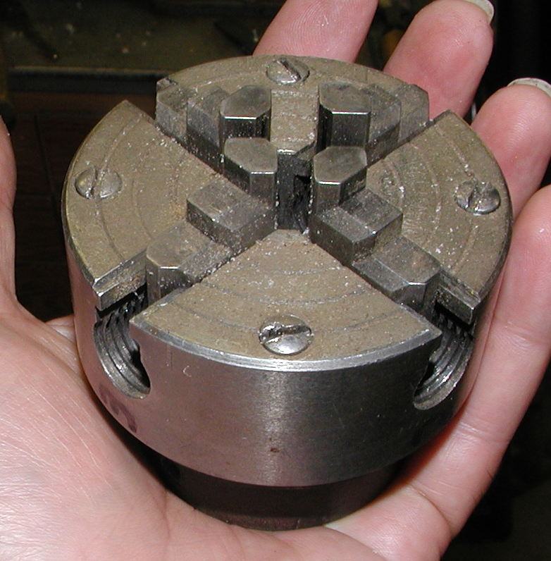

Self centering 3 jaw chuck is the workhorse. It is the late equivelant of a Jacobs chuck on your electric drill. When is the last time you fiddled with an electric drill to center the bit? Most round stock work is best in the 3 jaw chuck for that reason. It is fast. I rarely use the 4 jaw chuck, but for the times I use it, nothing can beat it.
If you make model steam engines, or do other machining like that, you will quickly find the value as you cut the cylinder and valve in a single casting.
I consider a 4 jaw chuck a lathe essential and would be lost without one.
It is like having a socket set without a 1/2 inch socket. (10mm for you metric guys) You can do lots with the set, but it is missing an essential function.
Note the bevel on each tooth in the photo below. This will hold bar stock, rectangular castings, etc just fine.
