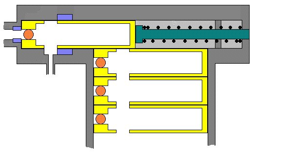

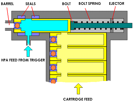

Ragnarok wrote:In fact, I think it would probably eject very violently. If you look, after it starts moving back, the entire frontal area of the cartridge is exposed to pressure, which means there'll actually be more force on the cartridge than the projectile.
Precisely, it's the same sort of stepped piston concept which pop-off valves use, as noted earlier on ;)
I've been thinking, perhaps the spring injector can be eliminated altogether and have the cartridge feed through side porting, in this way while it is being pressurised it will not move, until the projectile is released. Basically a combination of myoriginal cartridge prototype with the pop-off concept.
Also, provided that the air feed port is significantly smaller than the barrel diameter, therefore not providing a net force on the next cartridge feeding into the breech, it should continue to fire as long as air continues to be fed and there are cartridges in the magazine.
Finding the correct balance between sealing and friction would be crucial though, it doesn't need to be a 100% seal though as long as any leaks are minimal compared to the trigger flow.

That looks acceptable and much simpler, but it requires that you keep your cartridges clean. Which will be require active cleaning, seeing that they will be shooting all over the place.
Achieving a good seal should not be a problem, so long as you can make female O-ring grooves. You could even use floating O-rings. Perhaps that will need machining.
The risk of jamming should be about the same, but if you compromised with the side ejecting and ejected out the top using the spring force applied from the mag to the next cartridge, it would be less likely to jam. I really like side ejecting and bottom feeding, though.
It seems this is even better suited to using firearm cartridges than the previous version; you just need to cross drill and epoxy in a seal in the neck of something like a 30-06. That would complicate the breech (require a taper), but simplify cartridge construction. It's probably easier to make a jig to glue in seals than machine a fairly precise taper into that breech. Unless you cast the taper after the grooves were machined.
I think deciding on the easiest way to make this is harder than the hardest reasonable method.
Oh, and if you cut off airflow based on bolt position, you could have a larger air input, and MOAR ROF.

Dave_424 wrote:Im about to start another project using either the BACS cartrige system (I know you know what I'm on about)
For semi-auto I would exclude the BACS design altogether, too limited in terms of flow.
My experimentation with co-axial designs iswell documented, and for all my efforts I don't think they are a good idea for blowback either - limited chamber volume and the added weight and complexity of a filling valve makes such cartridges heavy, delicate and requiring a substantial hammer strike to open them.
This is why I think the above design has such promise - an extremely basic and light cartridge, with the ultimate zero opening time/maximum flow performance.
Everything will be machined and won't be a drop of epoxy in sight :D
You're lucky to have that luxury ;)
If I had a working semi/full auto cartridge fed design, I think giving cartridges a quick wipe-down would be par of the joys of using it :)
The performance potential of HPA + valveless design should mean sufficiently violent blowback for reliable functioning.
I can cast the breech around a cartridge blank with a couple of o-rings slipped over it, no worries there - I had done something similar for this detent. I don't think using firearm cartridges is a good idea, most of the ones in my collection are recovered ones of which very few are in perfect shape.
As with any project. I would much rather find the simplest way of doing things, regardless of the mental effort, instead of embarking on a complicated project then realise that I could have done things differently.
Good point, though in this case ROF isn't really what I'm after.

I'm just after a realistic clatter, no need for real brass for that ;) but continue reading, this will make it even easier to use actual cartridges:
I've been doing some more thinking after grabbing some materials, and I think I've hit on a way to make it even more likely to function reliably. I've removed one of the chamber seals, and moved the projectile seal from the cartridge mouth to the chamber breech.
This way, the cartridge will start to blowback before the projectile is fired. It will need some fine tuning to get projectile exit and blowback timed right, but that should just be a question of altering spring strength, ie more compression if the cartridge ejects without firing the projectile, less if the projectile fires but the cartridge doesn't eject.
It also makes the cartridge seal-free and therefore there is nothing to wear out.
Apologies for the incomplete cycle, I've had a long day at work and I couldn't be arsed staring at the monitor finishing the animation, time I could spend playing with epoxy
